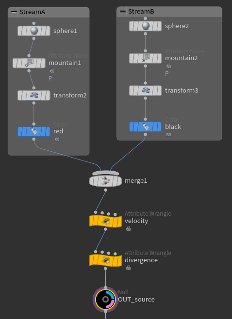

Wanted to share a recent lookdev experiment focusing on multi-fluid property propagation within the modern Houdini 21 SOP-based FLIP pipeline. The goal was to merge two independent, stylized emitter streams early in the setup while keeping a razor-sharp attribute boundary during violent fluid churning, splashing, and shearing.
The Setup Architecture
I focused on simplicity and I wanted to handle the logic natively within a single execution stream:
Early Point Grouping & Merging

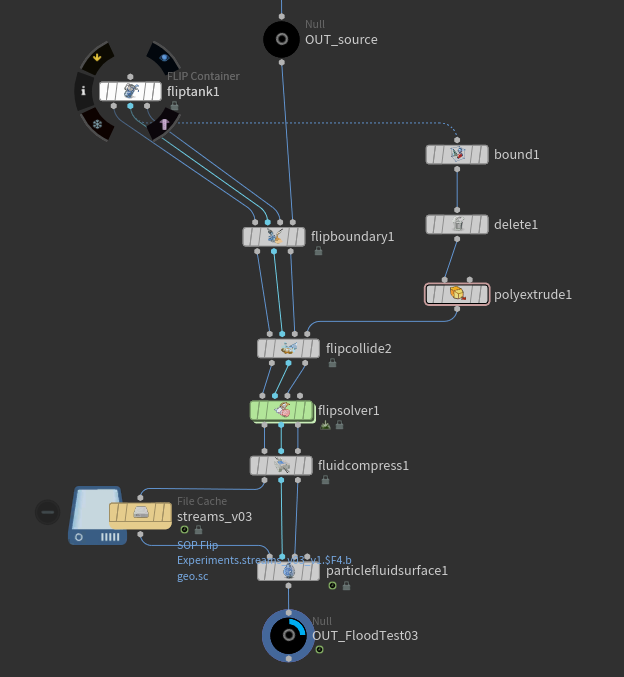

Stream A (Red) and Stream B (Black) are generated as independent polygonal geometry blocks before entering a single merge node.
The H21 Multi-Wire Trunk
The points feed directly into custom velocity and divergence attribute wrangles before being piped into the FLIP sim. From there, the data flows seamlessly down through the native multi-pass pipeline (flipcontainer ➔ flipboundary ➔ flipcollide ➔ flipsolver).
Solver Configuration
To prevent the attributes from washing out or diluting into a uniform gray soup as the fluids sheared, I disabled Particle Narrow Band and Reseeding
Meshing & Solaris Lookdev
The fluid particles were cached out through a fluidcompress loop and converted back to a unified geometry surface via particlefluidsurface.
