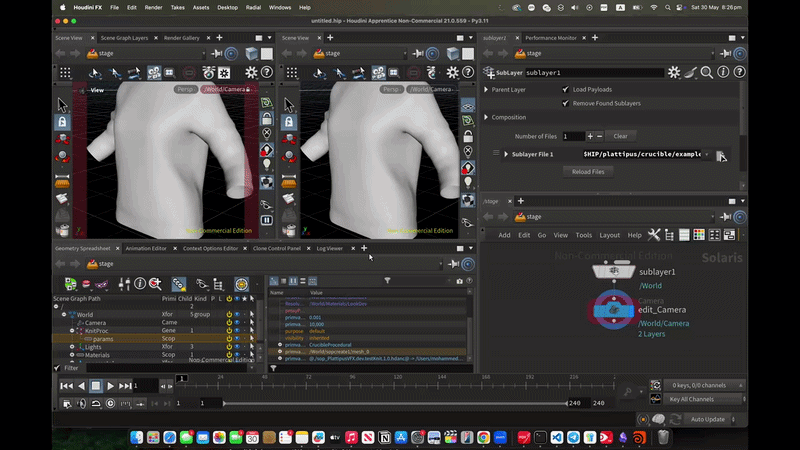

We just open-sourced Crucible.
Cook Houdini HDAs lazily at Karma render time. Just a single USD prim pointing at your HDA. Karma pulls, Crucible cooks, mesh appears.
MIT licensed. Built for production.
Write-up: plattipus.com/research/crucible
GitHub: github.com/plattipus/crucible
