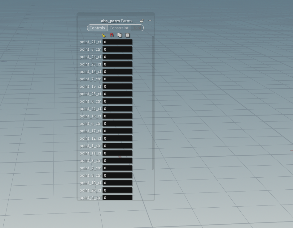

How to find and connect the spare ports of null and AbstractControl nodes in APEXSCRIPT?
I tried to use FindPort, FindOrAddPort, RenamePort and other ports to find the standby port of a node, but it didn't work. How can I use scripts to achieve the effect shown in the figure? Another question is that multiple data can be merged into an array. How can I operate if I want to decompose an array and output multiple data ports?
Attempts made (not beautiful):

Finally, I don't know how to deal with the display sorting problem:

There are a couple of ways to do this, however it looks like the sorting on the control in the viewport is a
bug.
Copy the snippet into a autorig component.
