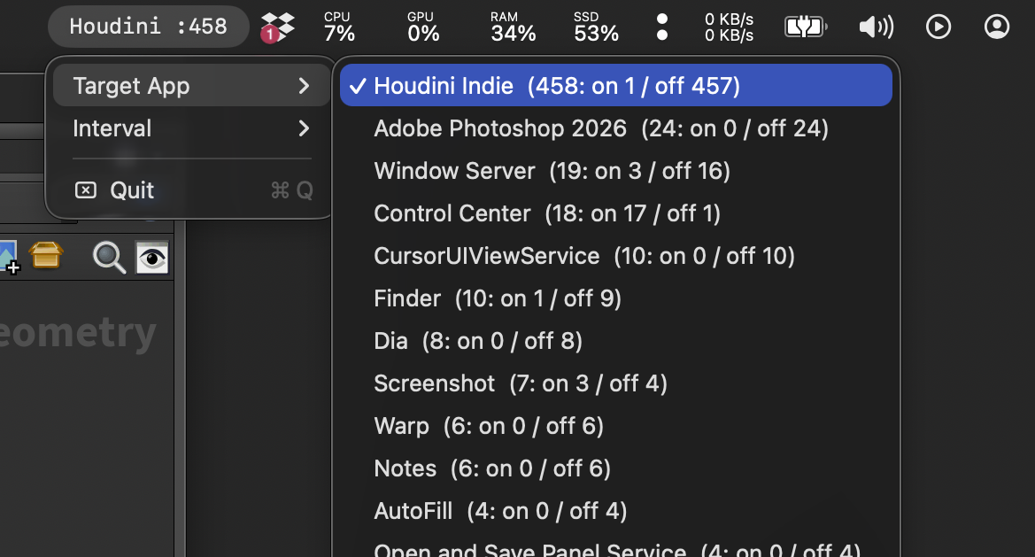

While trying to reproduce the issue consistently, I noticed a possible connection to invisible windows left behind by Houdini. macOS seems to allow external tools to query the windows registered with the window server (via CGWindowList) — their count, position, and size — so I built a small Python menubar app to do just that.
*This shows Houdini has created 458 windows, but only one is visible.
*Several other tools are running in the screenshot, but the results are the same with a minimal setup.
When the lag is at its worst, Houdini has accumulated a large number of invisible windows. These increase with virtually every UI interaction — opening the Tab menu, clicking a SOP node to show parameters, pressing D to open display options, and so on. Other apps also create and destroy windows during normal use, but unused windows are typically discarded. Houdini's process only ever accumulates them.
According to an AI assistant, even invisible windows are subject to hit-testing on every mouse drag event — which would explain why slower mouse movement reduces the symptoms. (I can't verify this myself, but it does seem to fit.)
To test this theory, I tried reproducing the issue from a fresh launch by rapidly toggling the Tab menu repeatedly. The lag appeared even on a completely empty scene. The rate at which it progresses seems to vary with environment (such as resolution of the connected display) but it provides a reliable way to reproduce the issue. Here's a recording:
