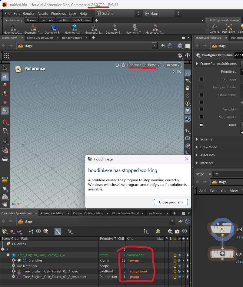

I downloaded some megascans assets which render fine with H20, but lock up/crash H21. H21 is definitely not liking the hierarchy as shown by the exclamation mark in the 'Kind' column in the Scene Graph Spreadsheet. I did try fixing it with a configure primitive lop but it still crashes.

H20 Render:
H21 Fail:
H21 Fail with reconfigured prims:

This is an issue with bad USD data, which only shows up in Hydra2 (H21+). The ueJointNames data is advertised as being of type token but in the binary USD file it's actually being stored as string.
It'd be useful to know how this file was generated, in case there's likely to be a lot of such malformed files out in the wild.
In terms of making things work:
- we're patching Karma to not crash on this (it'll emit a warning when it notices this)
- you can use usdcat to convert the .usd -> .usda and then usdcat to convert it back from .usda -> .usd (which will properly encode the data as token)
