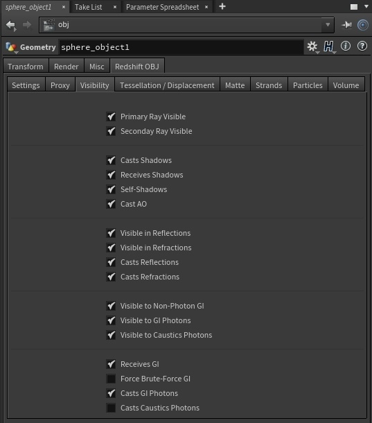

1. I was thinking about renderer-specific options per "visibility" collection (phantom, visible, matte).
In Redshift for example you could have these options. (Sorry I don't know what the Karma equivalents are yet)
More granular geometry visibility controls:
More granular geometry matting controls:
More granular light contribution controls:
So each collection (phantom, visible, matte) would have these settings to adjust.
In my opinion, this would open up the RenderPass node/workflow to a broader range of scenarios.

Thanks for clarifying #1. This would be a sensible future area of investigation for us. We do provide "baked-in" controls for this via the Render Geometry Settings (https://www.sidefx.com/docs/houdini/nodes/lop/rendergeometrysettings.html), but for deferred rendertime evaluation we currently only support what's in the vanilla USD specification.
If you could log an RFE for this, that would be great!
