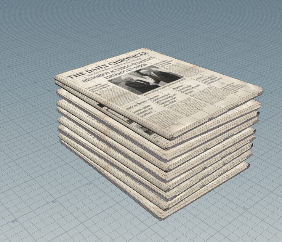

Hello! i just started learning Houdini and im trying to create a newspaper pile generator as a practice.
At this moment im trying to randomize the position of the first page of the newspaper over 3 positions of my texture because i want to limit the drawcalls.
Here i join a screencapture:

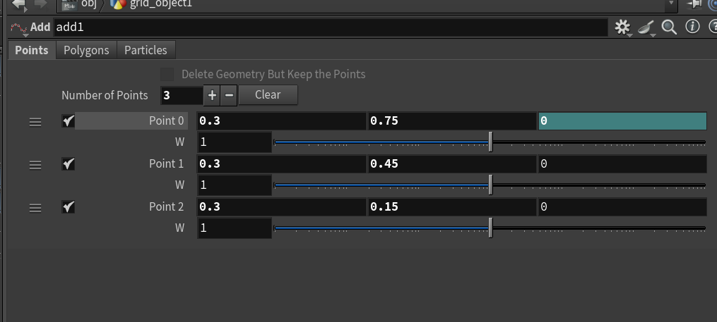

I've centered the uv shell with a vertex wrangle and some code i've found.
But i can't get it to move to the coordinates of the add node:
How can i solve this?
Thx in advance!

Hello ,
so you could use an expression like this in a wrangle (acting on point or vertices depending of your uv attribute kind)
v@uv+=point(1,"P",chi("point_number"));
the click the + stuff above the code to have the slider
then in the slider you can use an expression to vary the point to choose randomly with your iterations for example
