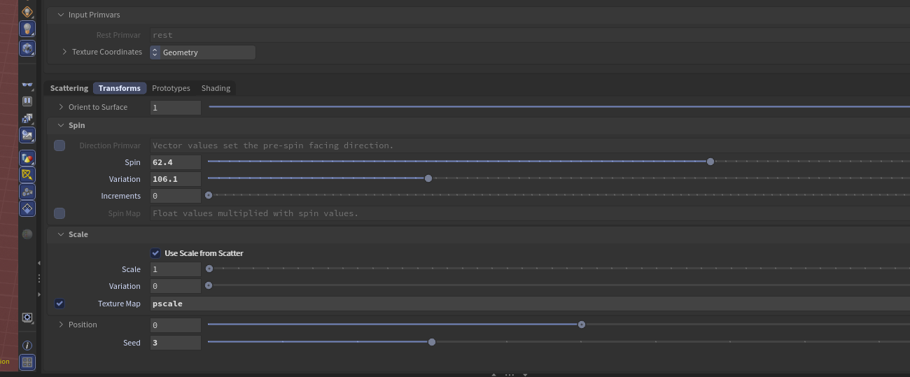

i am trying to scatter geometry on a surface using the scatterinstances node.
But i am not able to use a pscale attribtue to drive the scale.
In sops i am adding a attnoise beforce exporting.
Does the sopimport node recognize point attributes?
Thanks for your help!

It's not an issue with sopimport, the "Texture Map" parameter on the Scatter Instances is looking for a texture map file, not an attribute name. Please log an RFE for a Scale Primvar, it should be doable. It probably didn't come up earlier in testing because the terrain meshes were far too sparse for any geometry attributes to meaningfully influence the instance scales. Thanks!
