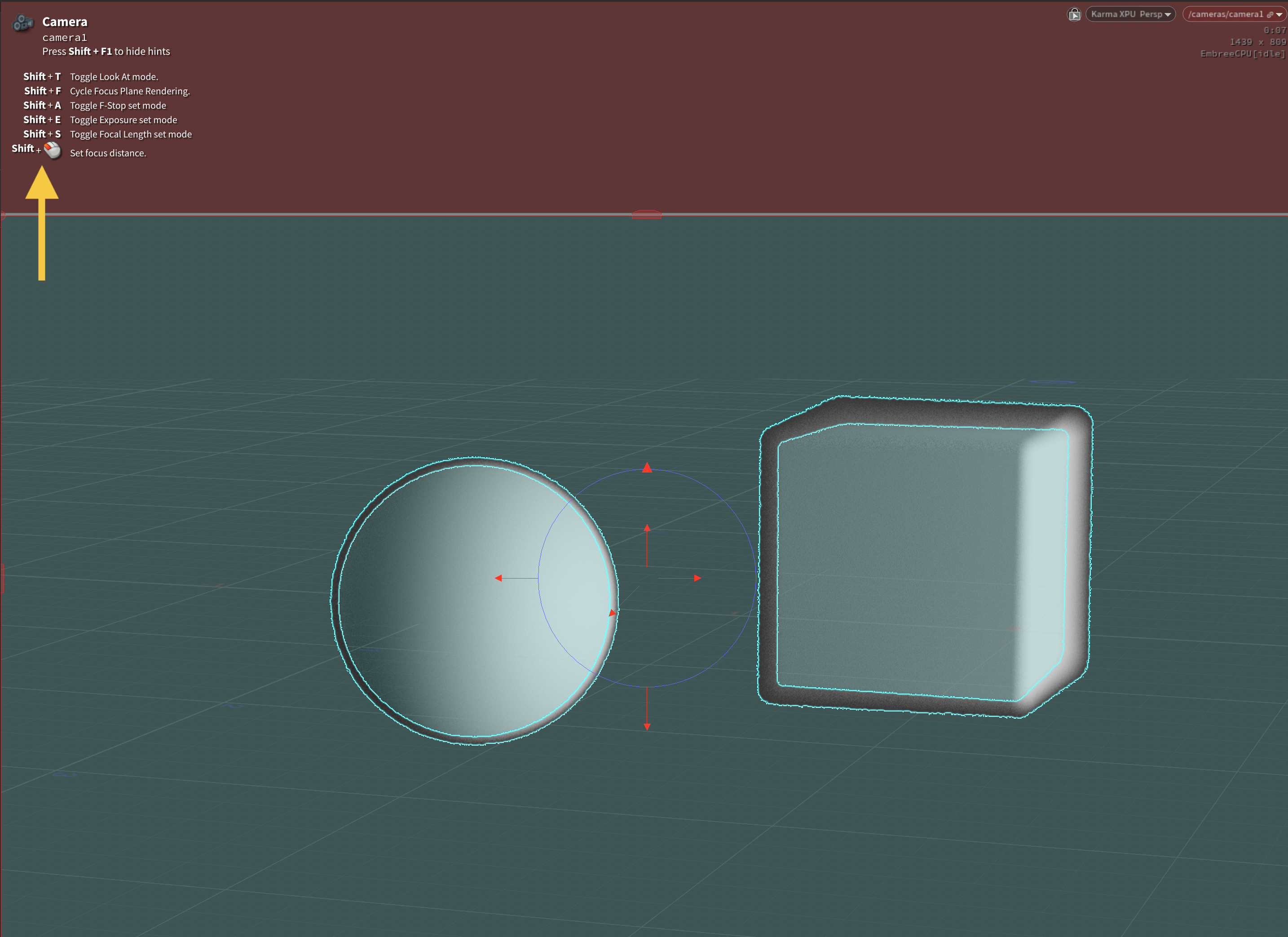

Thank you for your reply.
I’ve attached a screenshot to better illustrate the issue.
As you can see, I am already in Camera State, and the blue focus plane is correctly displayed in the viewport, which indicates that the camera focus editing mode is active.
According to the documentation and the viewport help, I should be able to interactively move the focus distance using the indicated mouse/keyboard shortcut (highlighted in the screenshot). However, nothing happens when I try. The blue focus plane remains visible, but it cannot be moved interactively.
To clarify:
* I am looking through the camera in Solaris/Karma.
* Camera State is active.
* The blue focus plane is visible.
* The documented shortcut produces no response.
* I have also tested different viewport renderers (including Vulkan), with the same result.
Is there another preference, viewport setting, or camera option that could disable interactive focus editing? Or is this a known issue?
Thank you for any suggestions.
To clarify:

goldleaf
What are you Shift+LMB clicking in the scene? I can imagine if a parameter were locked on the node, that might interfere with the state adjusting the focus distance correctly? It sounds like a bug, but I'm unable to reproduce it in a simple scene.
I am Shift+LMB clicking directly on visible geometry in the camera viewport, on the surface where I want the focal plane to be placed.
None of the camera parameters are locked.
I also tested this in a very simple scene: just a camera and some basic geometry placed at different distances from the camera. The issue is still present.
With the camera selected and the camera state active, Shift+LMB clicking on any visible surface does not change the Focus Distance parameter at all.
I have tested the same simple setup on both my Mac mini and Mac Studio, with the same result.
