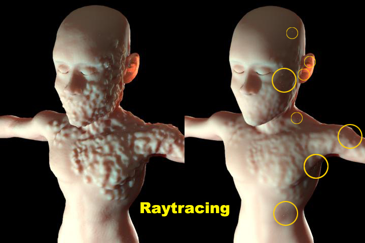

Serg
Trying some displacements out and wondering if you could help with some artifacts I've run into.
When using Micropolygon Rendering I'm getting some sparkle noise which increases greatly as I increase displacement amount. Increasing displacement bound doesn't seem to help.
Raytracing while slower cleans it up a lot, but I still have another smaller amount of white sparkles, which stays the same amount, regardless of how much displacement is increased or decreased. They are not really noticeable in the image I uploaded but they crawl when animated. I'll see about uploading a video but the renders are taking a while. EDIT: Here's a quick video [brandondunaway.com] of the raytrace render. You can see it mostly in the ear and underarm:
Any idea on a fix for this?

hi there,
That looks like bias related artefacts.
The problem is caused because this thing attempts to mimic the thinnest layers of skin, which is a very small number relative to distance to the camera… this makes it sensitive to precision errors. Tweaking the Bias should fix this.
The difference between render engines is because the raytrace engine appears to be numerically more accurate.
hope this helps
Serg
