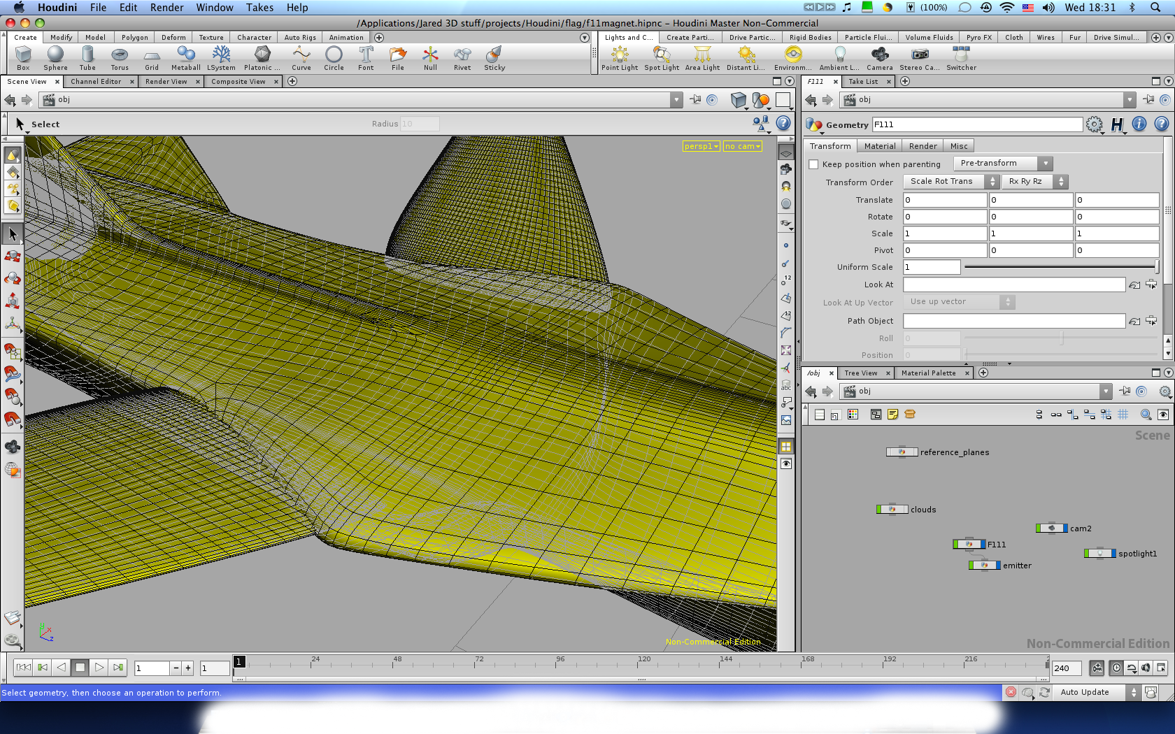

hey idk if i have something messed up but it's displaying all my objects backfaces…
Picture 2.png (558.6 KB)
Picture 1.png (411.6 KB)

Is this imported geometry? I've had something similar when importing some nurbs objects ( if I remember correctly).. if it is imported post which program its from, format, etc
45 posts
Joined: Aug. 2009
nope made 100% in houdini

I haven't seen this before and maybe it's a mac-specific OpenGL issue, but try adjusting the Near/Far Clipping Panes in the display options (d in viewport, under the Optimization tab).

I have many issues with the opengl display. Once you have an alpha attribute and transparency is enabled, houdini seems to not sort the primitives anymore and the viewport becomes a mess.
Do you have alpha on that geometry? I just always work with transparency off (display options, misc tab).

i did have a transparency on the reference planes i was using
