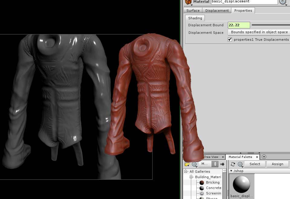

thanks mark, i was checking the size of the null still the original 1,1,1;
i did another test and created a new scene from scratch, i import the geometry, use basic displacement, and set the texture of the displacement been 32 bits. in the geometry node, i set it to dice to 6, and also set polygon as subdivision for mantra and still the 2.2 that i am assuming that is because the alpha deep factor is bake into, i did 22.22 since in the tutorial that i post earlier say that has to be 10
this is my first time attempting to render in Houdini, so i might be doing something wrong i guess.
