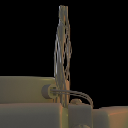

and the second one, i want to do a lot of cables with different thinness each one and just random along a thicker cable, i thought putting 1 thick cable, just a circle and sweep and skin it, and then use the same curve to sweep another little cables, but i am stuck, any tips?.

this is more less what i am aiming.
houdini cables.JPG (44.1 KB)
thanks .
Again use the local variables to do this. In this specific case you can use the $PATH local variable to add randomness based on each backbone.
