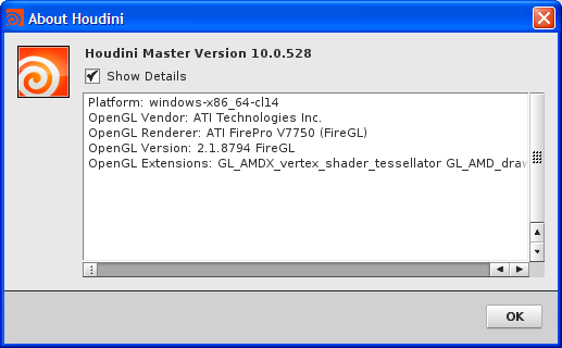

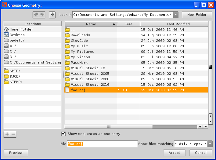

I just tried couldn't reproduce this problem on Windows XP x64. The only reason I can think of is that you're using some really old version of Houdini.
Here's the full path to the file I have:
C:\Documents and Settings\edward\My Documents\foo.obj
I start up Houdini 10.0.528 from the Start Menu. Then from the main menu, choose File > Import > Geometry…. This brings up a file chooser. I click on “C
” on the left hand side and then proceed to navigate down until find foo.obj and click on it, followed by Accept. This loads in fine as you can see in the screenshots.
