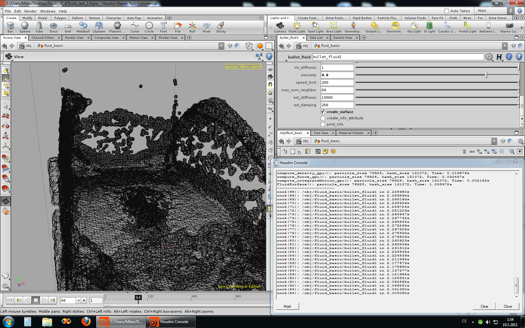

I start working on Surface Reconstruction for GPU solver.
Main work has done in GPU and first tests are fast(surface generation in houdini is very very very slow), but I have problem with memory limit and few holes in surface. At this moment It using Marching cubes algoritm and particles are representing like a spheres.
I decided rewrite all algoritm(I have many ideas) at next few days and this is my requirements:
-minimalize memory alloc
-metaballs
-faster
-metaballs
-faster
