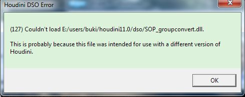

when i start houdini i get 2 error messages, the plugins work, but also get these messages every time i start mplay, which is a bit annoying.
Could it be that i'm missing some libraries from my system?
attached 2 images with the error.

buki
Could it be that i'm missing some libraries from my system?.
Do you have Houdini 11.0.469 ???
v0.95 is for H11.0.446.9, v0.97 is for H11.0.469.
Someone else has the same problem???

yes i have .469 and running v0.97, i was surprised too that had errors when i installed, im suspecting that i'm maybe missing some microsoft libraries.
If not much of a work, can You please compile it with latest production build.

neonshaun: yeh, I know about this, I have some plan for future development, so maybe next version
buki: I know where is problem
I guess that you have problem only with GroupConvert node, other are ok.
Problem is that v0.97 dont use GroupConvert and this node is not in zip file for download. And you have this node from version 0.95 which was compile for older houdini.
So solution is delete groupConvert. With v0.97 you dont have to use it. You have SOP_ShortGroup.

- buki
- 1773 posts
- Joined: Dec. 2006
Ah yes!! Thanks, so simple
