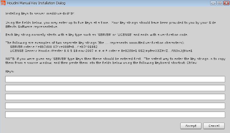

Hello. I have downloaded and installed Houdini Apprentice 11 half an hour ago and have ever since tried to solve a very weird font problem. It has never happened to me in previous Houdini versions.
Also, since I have to manually install the license, it is impossible to read my server details and continue.
I have tried to reinstall the default fonts in my computer (using the Windows repair tool), but nothing worked yet.
Even IF i somehow manage to install the license, I'm afraid that the font issue will exist in the program's interface, therefore making it almost impossible to work with.

Thanks - it's a known issue with non-workstation graphics cards.
http://www.sidefx.com/index.php?option=com_forum&Itemid=172&page=viewtopic&t=15604 [sidefx.com]

Yep, any OpenGL 3.0-capable ATI card should be free of these problems. It's only the OpenGL 2.0 and lower cards that appear to be affected. It looks like the culprit is a very poorly implemented GL_ARB_texture_non_power_two extension, which I'll be manually disabling for the OpenGL2 ATI cards (X1x00 series, X800/600/300). This should be fixed for tomorrow's build.
