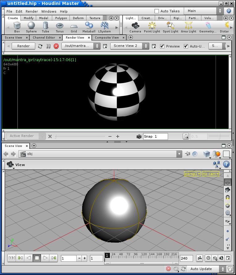

If you'd like to tumble using IPR you can do the following:
1) Create a floating Render Viewer or split your viewport in half and make one of the halves a Render Viewer and the other a Scene Viewer.
2) Select a Scene View camera in the Render Viewer's camera menu. This will keep the two camera's in sync.
3) Start a render in the Render Viewer.
4) Rotate your sphere in the Scene Viewer and watch IPR update simultaneously in the Render Viewer. If your scene is quite simple, try lowering the Update Time and Delay Time in the Render Viewer for a more interactive experience.
