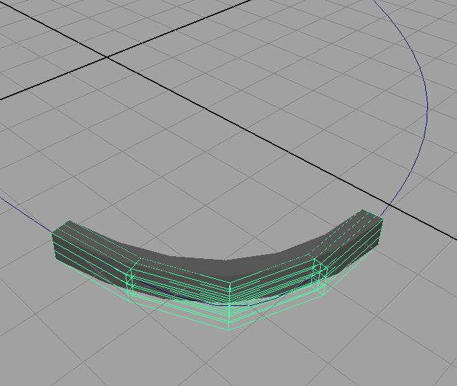

I would be very happy if there are any resources on this. … Have been looking on odforce and here for a while. I am looking for a way to attach an object on a curve, then animate it along that curve and also get it deform as it flows. Just like the Maya tool:
Animate->Motion Path->Flow Path Object
(see the image please)
I tried various techniques, latices etc. But no success. It is supposed to be easy Just wanted to be sure if I am not missing a simple solution…
Maybe wireDeform and wire capture?
Any ideas? Thanks.

Something like this?
(About 5 minutes in…)
http://vimeo.com/8378129 [vimeo.com]
I haven't released this yet because it's not finished. It is created with the creep sop. Basically you sweep a line up a curve and use creep to deform your geometry along that surface. You can do some math to figure out how to center your object and determine the settings for the creep operator so the geometry does not appear stretched out.

It worked. Thanks for the idea. The creep part is a bit manual. In terms of figuring out the length of the sweeped geo and then the propotions to fit the actual geometry on the sweeped surface. The mesh that drives the creep is 2D at the end right? it is just a nurbs surface generated from the line sweep?
Thanks.
Live life in chunks.
382 posts
Joined: Oct. 2008
Yes, you are driving the mesh with a nurbs surface.
The length, width, and depth can be figured out exactly with the right formulas, taking the bounding box of your source geo into account. I don't have my file with me at the moment, but I'll try to post it tonight. If you know the formulas, there's no need to guess.
