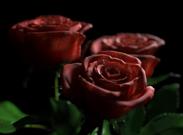

and some roses…
PBR and some SSS.
these were all in the 5-8min range

Joined: July 2010
with real dof or post?
78 posts
Joined: April 2008
sampled DOF.

330 posts
Joined: July 2007
the second frame of the roses is really beautiful !
it is good to see mantra used to produce such details , beside the usual dust'n'smoke'n'fire …
im really curious to see the level of detail of their geometry …
any wireframe screenshot ? what app is used to model those ?

78 posts
Joined: April 2008
We have a job coming up that we need to wreck enough stuff that I'm reluctant to push stuff back into Softimage for rendering. Usually for us Houdini is dust/smoke and we comp it into MR renders.
As far as the flower petals go it's all modelling other than the veins which are textures.
And from my tests I'm not scared to render our standard robots/cars in Mantra. Seems more than capable in most areas and more capable than MR in mblur/displacement/dof world.
