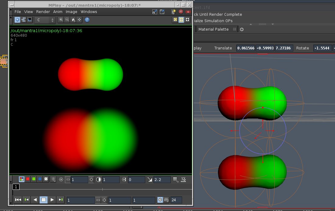

I was trying to render some metaballs as volumes this morning. To my surprise, they all came out as a bunch of overlapping spheres. I was hoping the blobby field defined by the metaballs would render. I have attached an image with the metaballs rendered as geometry at the top and as volumes at the bottom.
Is there any way to get the volume render to match the geometry one better?

The metaball surface is created where the sum of the weights is 1.
However, a volume will render, even if the density is 0.1.
If you wanted, you might try changing the surface shader to subtract 1 from the density… I'm not sure whether that will do the trick though.

Thanks for the reply Mark, guess I am going to need to stamp it in a
volume after all.
This is for things like missile trails etc. I think it would be very handy if there was an option to render metaballs that looked as if I had converted them to a poly object, ran an iso offset and render that, but then without actually creatin the geometry or the volume.
Do you think something like that is possible?
