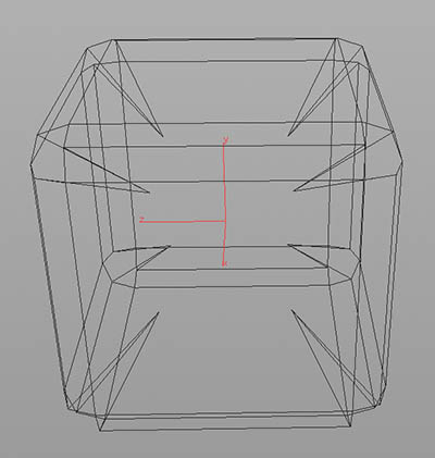

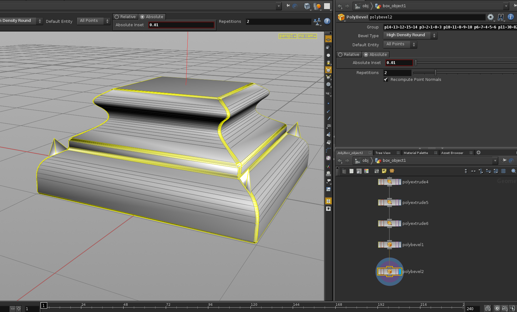

Hi guys, I'm just starting to learn the basics of Houdini and I thought I'd start with the Quickstart tutorial on the SideFX website. I am following the steps exactly trying to build a Greek column from a cube. There is a bunch of edges that get a relative polyBevel and then some more edges after that get an absolute polyBevel.
Now here's where the problem happens, when I try to increase the repetitions of the second polyBevel I get corner edges extending right through the entire model and sticking out the opposite side like spikes. See attached images.
I have watched the steps in the tutorial several time and tried to replicate the steps, but each time I get the spikey edges.
Can anyone tell me why this is happening and is it something I'm doing wrong?

not sure why my images didn't work..? I'll try to re-attach them.

Ok I tried just getting a basic cube, then I selected all edges and I applied a polyBevel with ‘high density round’ and in absolute mode. The same thing happens (see attached). Is it possible that something in the preferences is set incorrectly?

that sample scene you sent me also had the spikey corner issue happening. How did you make that happen?

i make video of simple wrong bevel from tutorial
http://youtu.be/1RaSmVz-R3Q [youtu.be]
and my nice cube
