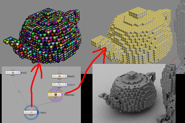

Cant understand about random colors on instances mats…(((

i cant assign random color as they say in tutorial.
Good on last copy-node, but no on instance

Set the colour sop to random and by pass the material sop , make sure in the copy sop your transferring the attributes from the point to the copies.

but “copy” use only for viewport.
real mesh for render created by instance from material node. how update individual colors of instances mat?

In the material1 node set the “attributes” parameter to “point attributes”.

Ok. Then you will have to upload a new file. The one a few posts up is set to primitives and switching it points gives me random colors in render.

understood
I probably got confused in viewport visualization of instance. In tutors was h11. H12 already set view instance ON.
