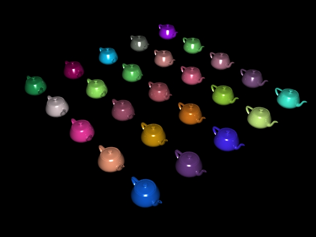

Scene attached shows how to make a ID pass with instanced objects, use the inspection tool in Mplay to read the point number.
The scene also shows how to override the dif color per instance via the creation of an attribute based on the point colour. The overridden colour is then rendered as a image plane. Any questions feel free to ask.

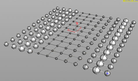

Technique , Use a ramp in VOPs to out put an attribute which then can be remapped to the pscale attribute, to art direct the size of spheres
rob
