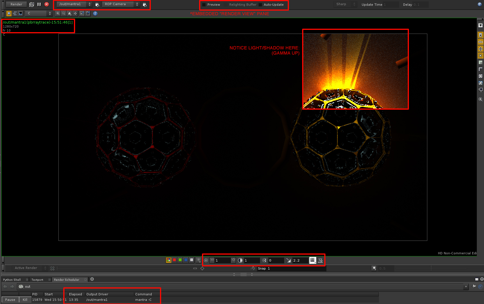

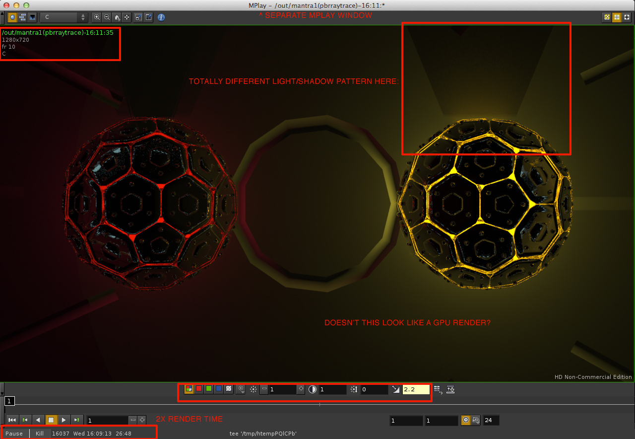

OK, I've got it down to a reasonable render time, but I'm still having the issue between the “Render View” and the mPlay/hbatch windows.
Just to prove I'm not a crazy Noob, I've screen grabbed the results from the Renderview and the mplay window. Both are rendered with exactly the same ROP, no changes. As you can see, the results are very different, both in render time and in final result. The renderview is quicker and a bit nicer, but I was unable to get hbatch or mplay to match.

There are quite a few options enabled. Can you try with a new manta node with PBR.
