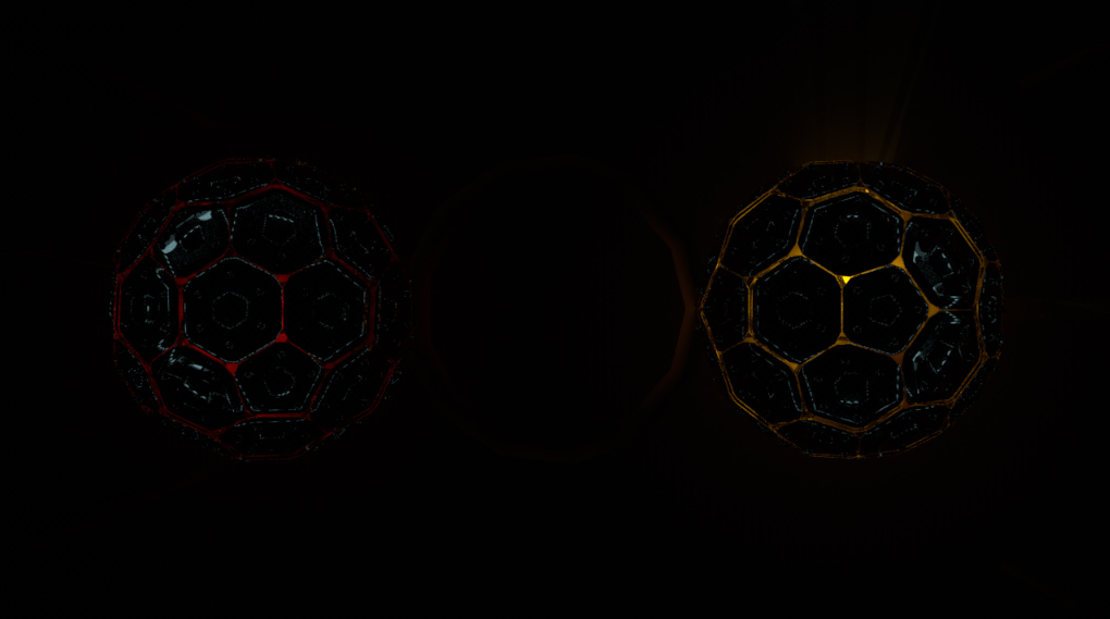

Spoke too soon!
I don't know what's going on here. I've attached two screengrabs - both from exrs read into nuke - one from the render viewer, and one from the mantra hbatch render.
Not only does the mantra render take 4x as long (2hours vs 30 minutes) but the lighting looks totally different. It's something I could fix with CC, but why is it taking so much longer?
I must be missing something about how the render viewer works. Am I wrong in assuming the result I see in the render viewer should be identical to the result from a command line renderer?
I have already told you the IPR uses ray tracing so clearly your render engine on your mantra rop is not set correctly. I can see from your render you have just about every bell and whistle turned on !
