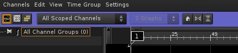

If I try all available Color Settings (themes) including downloaded hand full.
And even rig and edit my own custom hcs file (or I suppose you could just edit a downloaded one).
None of them ever change the Channel Editors “tools scroller container's” background color (see sample image) from a hue of about 240 seems like a brighter royal blue.
If some one can tell me what the missing color name in the settings file is I can add it manually to my custom color settings file hcs in my user config folder.

Isn't that just the colors that start with “Toolbar”? The default dark color theme doesn't have that purple for me in the Houdini 12.5 daily build.
That makes no difference ….
ToolbarBevelLight: 0.025 0.16 0.18
ToolbarBevelDark: 0.03 0.08 0.12
ToolbarFlatGradHi: 0.1 0.256 0.2 // Top/left end of gradient
ToolbarFlatGradLo: 0.06 0.035 0.09 // Bottom/right end of gradient
Still purple for all settings files all the time, for the unknown value.
I've scanned fro the color itself and likely inspected each color for anything remotely purple and found nothing, so it seems to an be undocumented name or broken certainly purple would not be default (I suspect a green reference is missing).
