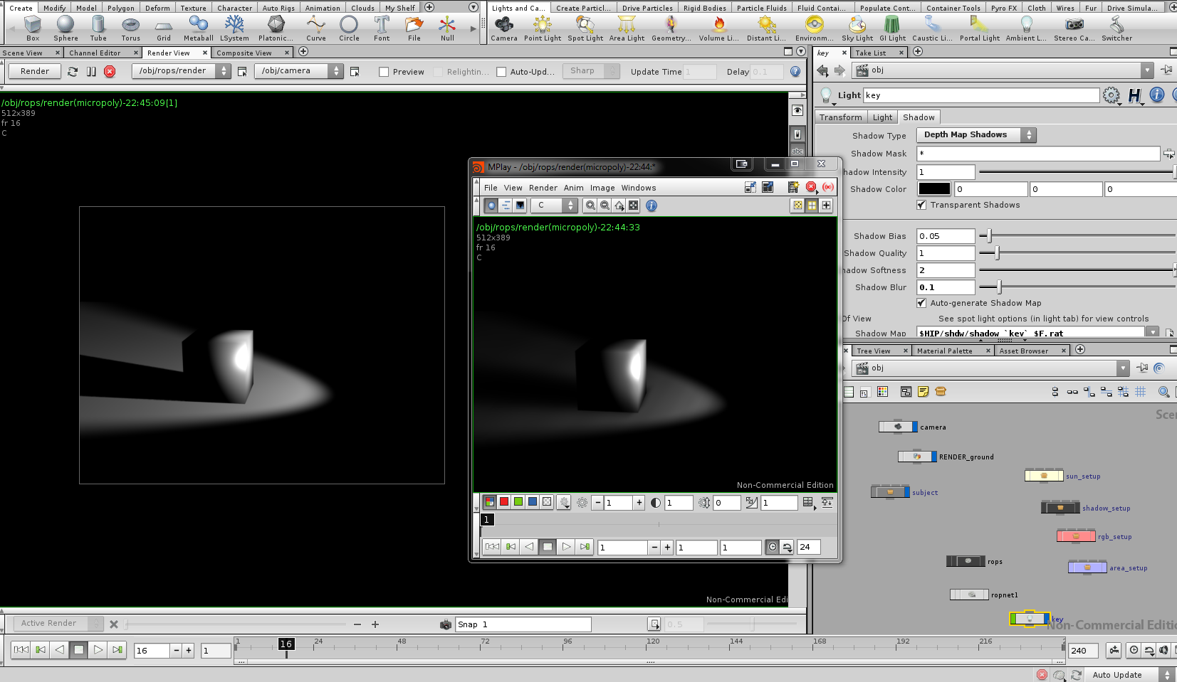

Getting a different output when I use the render view and mplay, have clicked render on both and I believe the mplay output to be accurate as i've added shadow blur and softness but that is not appearing whatsoever on the render view render. I read in the forums a lot say that having preview on makes it go to raytrace but i've not had preview on whatsoever so i'm out of ideas.
I've attached an image
Contrasting outputs from render view and mplay

For anybody interested had a look at work with a version 12.0.1 and it worked fine with exactly the same settings so reported this to sidefx!
I was using Houdini apprentice 12.5.46 and it wasn't changing in the render view whether preview was checked or not but I just installed 12.0.1 on my laptop at work and it works absolutely fine:
So this is now producing the blur and shadow softness from the depth map parameters
http://tinypic.com/r/2dlp5x3/5 [tinypic.com]
This is the default:
http://tinypic.com/r/2gwdpvs/5 [tinypic.com]
Where as before in 12.5.46 I wasn't getting the changes from the blur/softness being adjusted.
