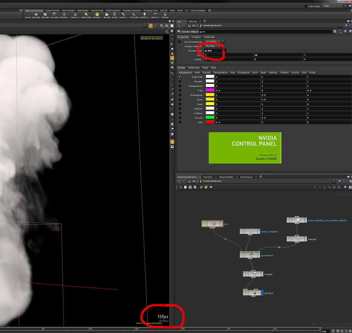

I just tried to turn of the lighting but there is hardly any difference. The framerate goes from 4.6 to 4.8 on the geometry file. With pyro there is no difference at all.

I think the volume case is strictly fill rate limited. The volume shader is dead-simple and so is the geometry, but it draws a lot of parallel planes with blending. The K4000 has better texture sampling than the 480, so I don't believe it is the limiting factor, unless the texture sampling and framebuffer writes are competing for memory bandwidth and being limited there.
You can try reducing the Volume Quality to Low in the Geometry tab of the display options, and also the Max 3D texture size in the Texture tab (say, to 128).
