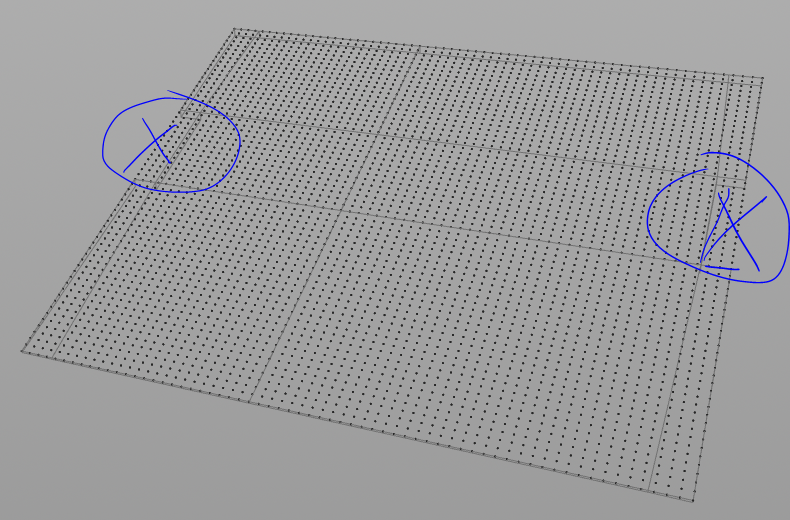

thanks for your input but the problem is with a subdivide is that i dont get a correct layout of the points, see image
or am i doing something wrong there?

Oh, that looks strange. You could just increase the Rows/Columns on your Grid SOP as well. Or on your Subdivide SOP, turn on “override crease weight attribute” and pull it to the max.
edit: I suppose I didn't get that you have your own geometry. In that case you can just do the above, and then Ray SOP the points on the geometry. That is, create a grid above your geo, subdivide it, make it into points, and Ray SOP in negative Y.
