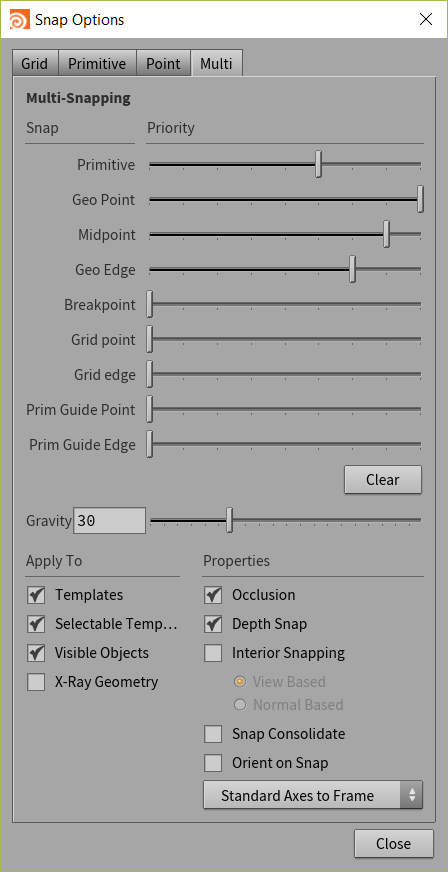

OK, so about snapping.
I've written a rather long winded explanation as to why the radial menu is a gimmick for snapping, but I've reconsidered posting it and realized that all that is necessary in order to have a workable snapping is to have the X key remain transient when you reassign it to multi-snapping.
For some reason only keys that are assigned to radial menus are transient. That's too bad, I hope it won't be the case in the near future.
There's one option regarding multi-snapping that is unquestionably missing: after I make my changes, Houdini forgets them next session - there should be a “save as default” button.
As a side note, right now all the sliders for the snapping targets, “geo point” being the exception, are all the way to the left, which apparently means turned off. If you activate multi-snapping it probably means that you want more than points to snap to. I've attached a default which is IMO the most useful for modeling, but this pales in importance to the options save functionality.
I will file a RFE for this and cross snapping off the list as I'm very optimistic about more transient options in 17.
If you think you have better ideas for snapping let's hear and dissect them.
