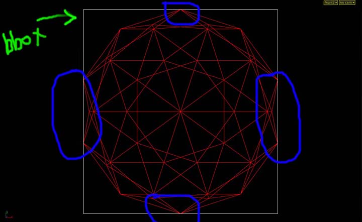

I think this is not a problem or bug in the Transform SOP !
Different size of the Bounding Box in the different frames is logical ,Because we don't have really perfect sphere in the 3D ,each sphere made by connecting too many triangles or squares (Polygons) with together !
Exactly like rotating Cube instead of the Sphere !
like uploaded images .
So you can see this problem will fix , if we increase number of the polygons !
That sound's like Houdini convert NURBS and Primitive object to the polygon for computing Bounding Box.
Also I checked it in the Maya with same result !

I have now analysed this problem as far as I intend to.
I had some misconceptions of what the radius of a circle means to Houdini. It is not, as I assumed, the distance to each point on a sphere but the distance to each primitive. Hence Joker86's analysis is correct. The more polygons you use to define the sphere the less the bounding box grows and shrinks as the sphere rotates.
