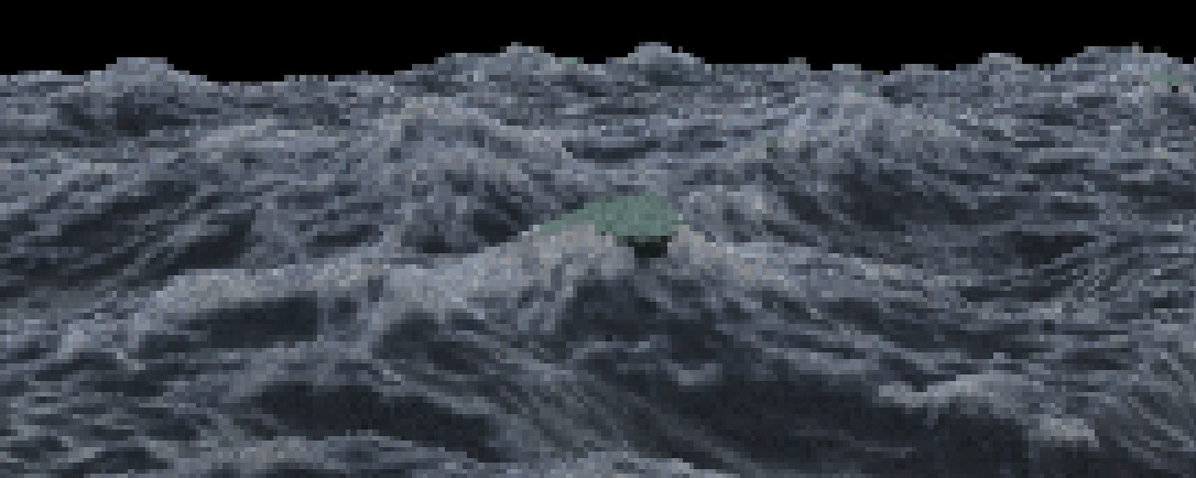

Well, right now Houdini is breaking up every three minutes. Seems that some cache, preferences or whatever got corrupted.
So all I can offer is the last render where the particle separation of the fluid was still at 0.1. It still doesn't look like foam to me, but I'm pretty sure the problem sits in front of the computer having a headache. ;[
This is the whitewater of a shelf Wave tank with nothing changed but the wind speed and the chop cranked up.
Any help - anyways - is very much appreciated.
(I'm not posting the hip right now as don't know if it wouldn't ruin somebody else's system.)

Good afternoon.
Let me add another problem I have (assuming I try to solve my task using the shelf “Ocean Waves”).
From time to time the Interior of the fluid seem to come above the surface. causing atrifacts. It seems to me that this ist where there should be a lot of foam.
Is the sitting bug inside Houdini or in front of my computer?
