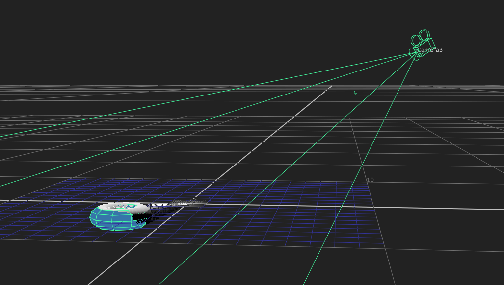

For some reason when I import the P (world position pass) into Nuke, it imports directly onto the negative Z axis every time, no matter where in the scene the object is. No matter the scene, no matter the object.
I've tested this with Mental Ray Vray and Arnold and all three renderers put it in the right place in Nuke's 3D scene (lining up with the object in the camera view). \
Why isn't the World Point Position Pass transferring to Nuke while the alembic files export to the right location?
Here's what I get in nuke with Houdini's Mantra.
THANKS!!

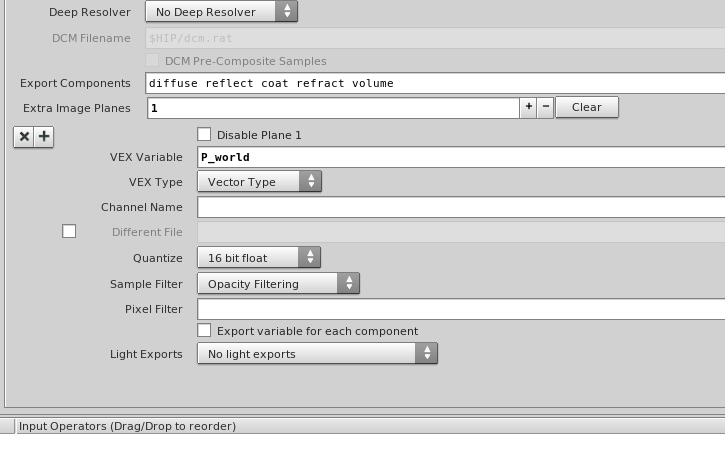

How can you export the new P parameter from Vops to the mantra AOV (extra image plane)?
I assume P is being created from the material so each material would then have to transform P from camera space to world space and export that variable (somehow) back to the AOVs through a Parm node or something?)

All sounds correct. Create an export parameter in each shader. in the example attached the world position Aov is called ‘P_World’
Nuke, Houdini, .abc and exr files in the .Zip file

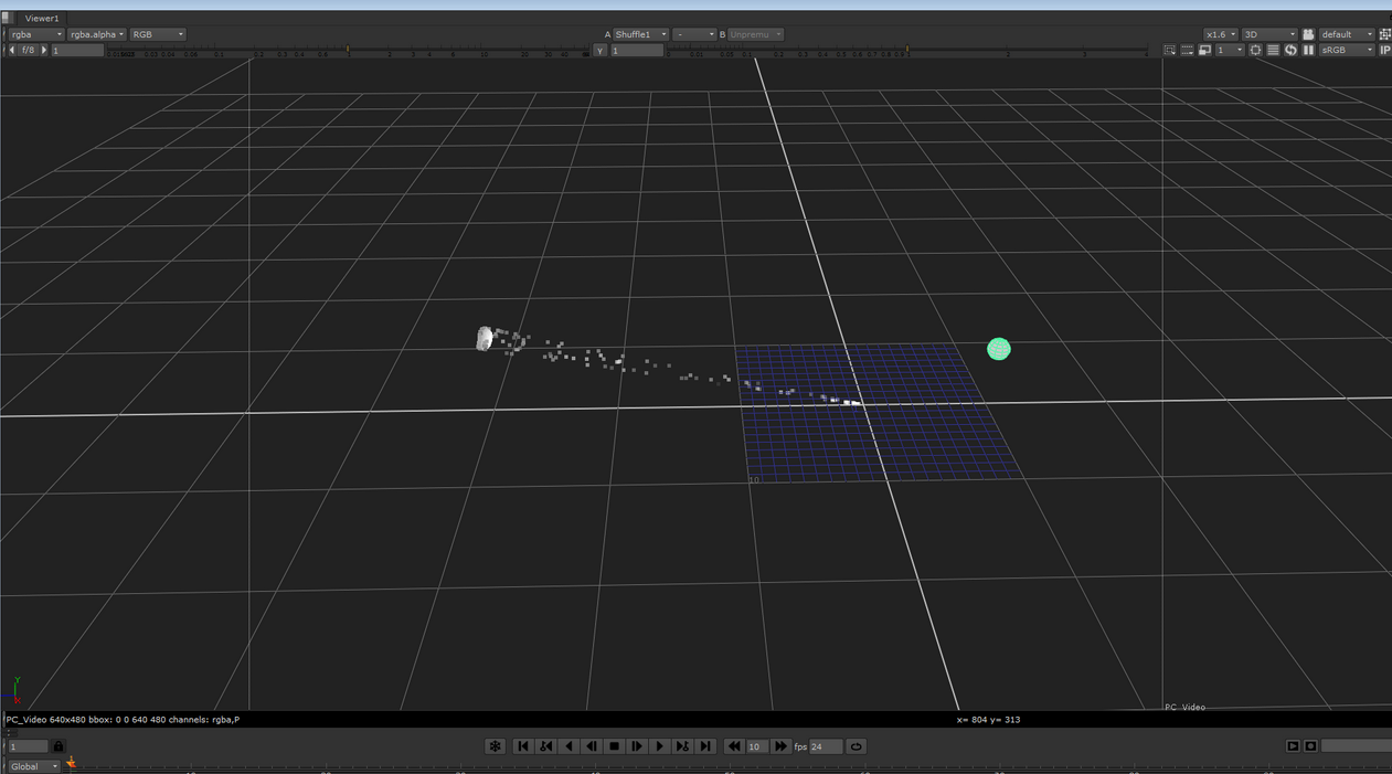

I was going crazy with this and I didn't have time to rerender just to do a relight in Nuke, so I just placed the camera at the origin and swapped z in the position channels on the render.
set cut_paste_input
version 11.3 v6
push $cut_paste_input
add_layer {P P.red P.green P.blue P.x P.y P.z}
Expression {
channel0 {P.red -P.green -P.blue none}
expr0 P.x
channel1 {-P.red P.green -P.blue none}
expr1 P.y
channel2 {-P.red -P.green P.blue none}
expr2 -P.z
name Expression1
selected true
xpos -1164
ypos -1370
To get back into worldspace, I just did a transformGeo of the entire scene back to the original camera coordinates.
