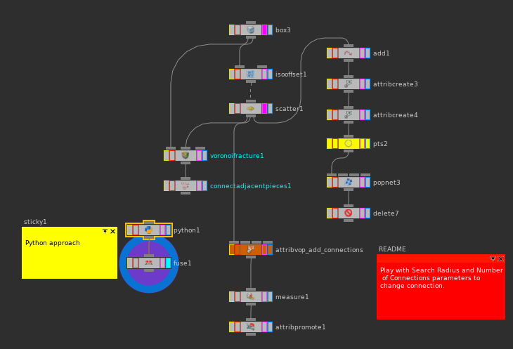

I'm trying to use the following Python node to do it, but I still can't get it working and no line is drawn …. Appreciate if you can take a look and point out the source of problem of my approach!

sorry, I found my python approach did work, but a fuse node is needed to merge the overlapping points generated in the process.
Moreover, I found that PradeepBarua's approach may not work when try to get the max number of lines between all the points, e.g. there are 45 lines btw 10 points maximally… Can PradeepBarua kindly check and advise?
BTW, the popnet node is to animate the points which gives interesting results, and pls try out by using the delete7 node as input!
One problem is that I don't know how to “kill” those points reaching their life span which stop at the outermost region ….

Change:
line = geo.createPolygon()
to:
line.setIsClosed(0)
You need to define polygon as open, otherwise it's closed by default.
Better solution would be create new Python type Operator and use existing points (from the first input). In your approach you are creating too many new ones that you don't need.
