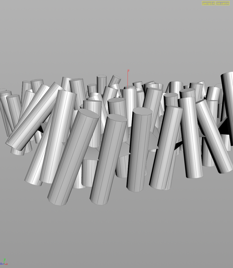

I am trying to copy tubes on a grid but i need the tubes to “start” on the grid instead of halfway like in the image. How can I do it?

Change pivot of tube centre to bottom.

Or translate it up using transform SOP.

like PradeepBarua sad. here is a example.

Another way could be to put down a transform SOP after your tube or whatever object and in the x, y or z translate type in the corresponding “-$XMIN”, “-$YMIN” or “-$ZMIN”-Expression depending on the global alignment of the object and the normals on the copy template.
In case of a tube use the z-channel
That way, no matter what input geo you have, the lowest point of the geometry sits on the ground.
