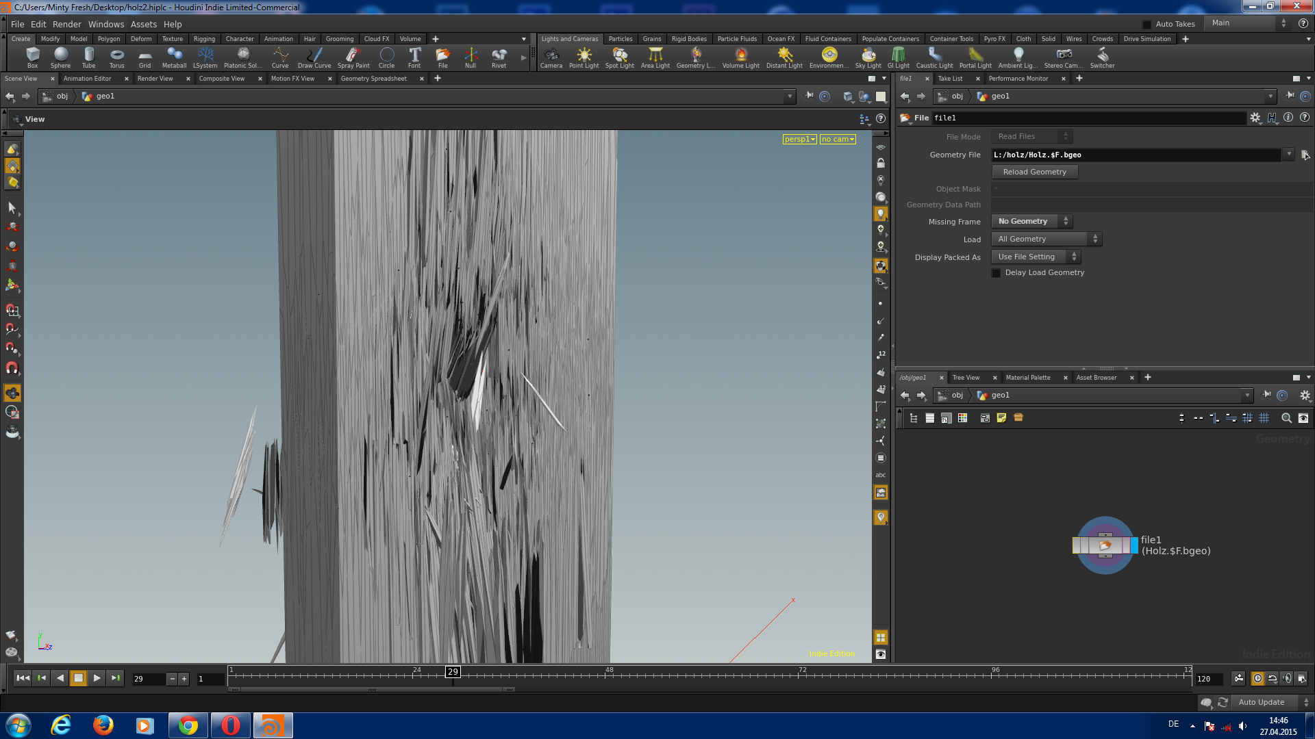

I animated a bullet flying through a piece of wood. The problem are some strange spheres which can be seen in the viewport as well as in the render. Its a bit annoying. Don't know how to get rid of them, don't even know what they are.
I will upload some screenshots. Maby someone knows how to make them invisible.

3467 posts
these are likely single points that are left over from your fracture…
just before you send the geometry to DOPs put down a group node, set to primitives, group name something like all_prims, then a delete node - with all_prims in the group field and delete non-selected…
this will delete anything that isn't a primitive - ie the stray points…
HTH

Great, thank you!
I never would have figured this out.
