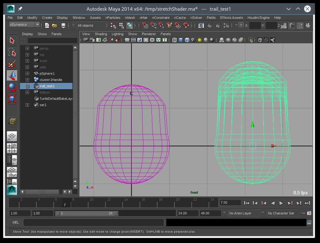

Hm, what I see is that the cluster deform is being applied twice. Once to the input geo, and then once again to the output geo. This results in some kind of double deformation. This is definitely a bug. Is this what you mean by “not working”?
If so, then it's actually possible to workaround the issue. This is happening because cluster creates some sets (tweakSet1 and cluster1Set). These sets are being inputted into the asset as groups. This is normally harmless. However, when these groups are being outputted back into Maya, for some reasons, Maya apply the cluster deformation again to the output geometry. So the workaround is to simply delete all the groups inside the asset, so that these groups aren't outputted back to Maya.
Otherwise, the trail does seem to work for me.
