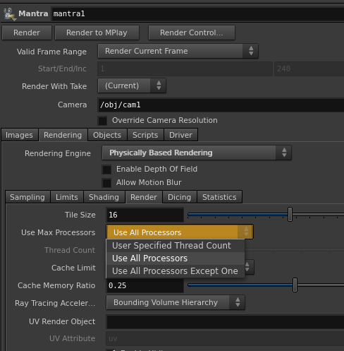

However you can define number of CPU before rendering in the Mantra node –>Rendering–>Render–>Use Max Processor parameter.

I also found that I could do it on the Mantra node > Driver tab > Command
by adding -j X at the end of the line. X representing the number of cpu used to render.

hi,
Take a look at this:
Mantra => Rendering => render=> Use Max Processors.
see the attached image.
