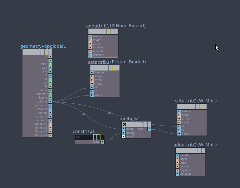

I am confused what you mean by it only holding one number? You can have multiple wires leave ptnum in Attribute VOP, just like you can have multiple wires leave ptnum in VOP SOP…?
Are you referring to how the 2048 is replicated down the chain? That is because addattribute() is setting the *default* value, not the current value. This should have worked as you expected with a setattribute.
One note is that if you are writing to your currently processed point I'd recommend just using Bind rather than Add Attribute where possible. Attached shows setups using either set/add pairs or Bind Export.
Here comes my question. How can i use the newly created attribute? I want to manipulate it further (just multiplying with 2 in this example) and create the final attribute.
I tried to use Get Attribute and Find Attribute but I cant get back the correct Attribute values.
You can't inspect the value of your newly created attribute. You have to split a wire out from where you wrote the value. Points are processed in arbitrary order, so it is not meaningful to ask what the currently changed value is. The Get Attribute will get the value *before* you started all your manipulation at all times, as that is the one consistent value available. In this case this distinction isn't important as you have the value you wrote to PtNum on a wire ready to pass down to the second set attribute.
