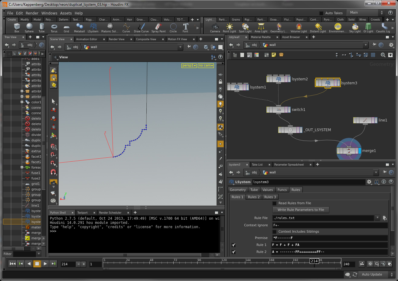

Working on a simple tool for interior walls and “grid windows”.
Bevels are made with L-Systems.
Have to refine the wood shader and putting all together as an otl.
129 posts
Joined: Jan. 2013
“Bevels are made with L-Systems” ???
483 posts
Joined: Dec. 2006
I've used L-Systems to create the profiles and then a line is connected to the last point to have an adjustable width :-)
I'll add some more different profile types to the final Asset, to make it more useful.
