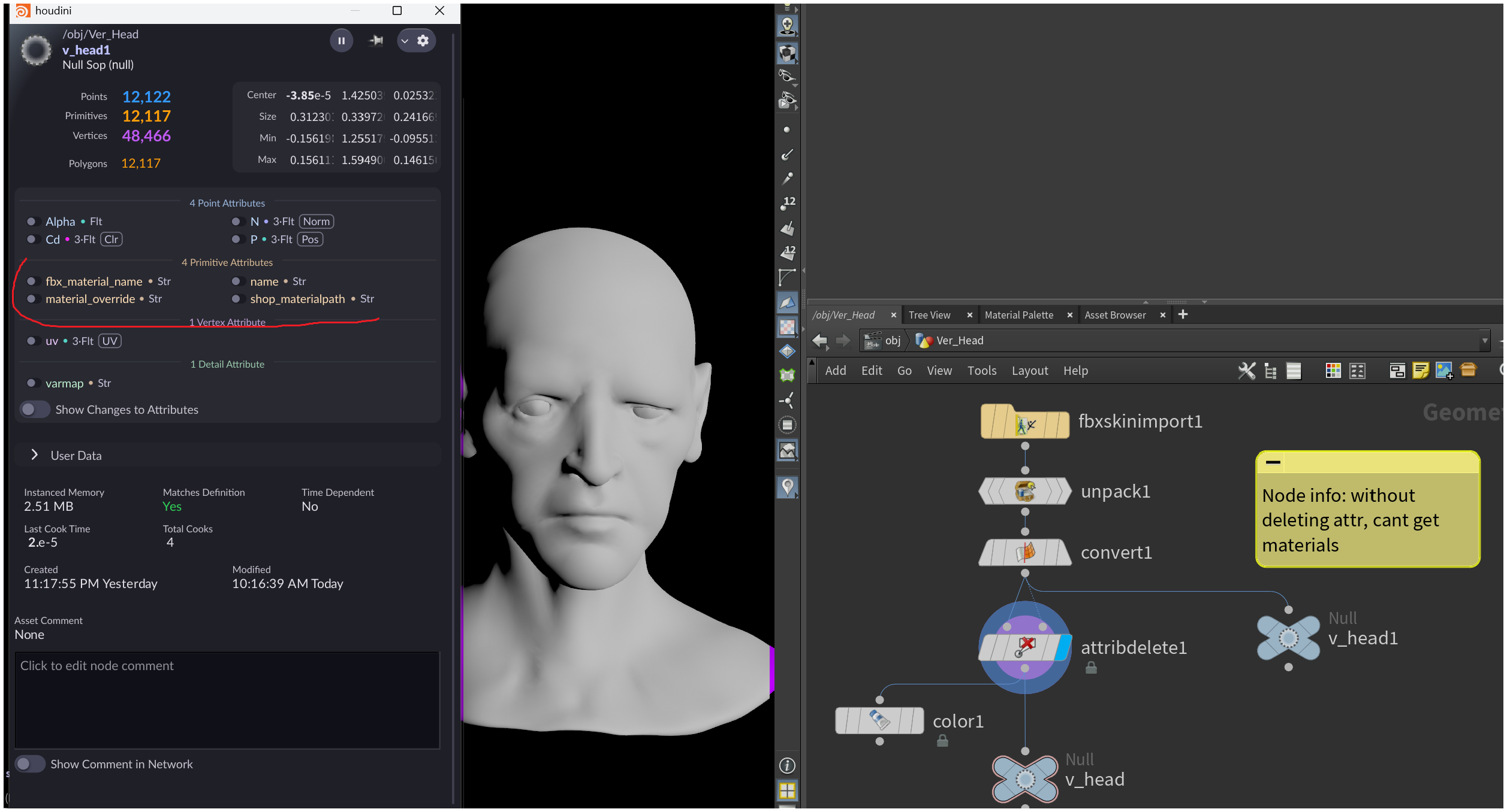

Joined: April 2025
Hi! (if this may beusefull for someone reading 10 years later and having the same issue) On my case It helped add an attribute delete to my geo and delete all that was coming with my imported fbx, I noted in the node info with and without the attribute delete that there are some fbx_material_name and material attributes that are coming with the file imported by default, after deleting them, and leave it <clean> the geo shows the material from you mat palette properly.
Tick "delete non selected" on your delete attribute node, btw.
Hope it helps!
