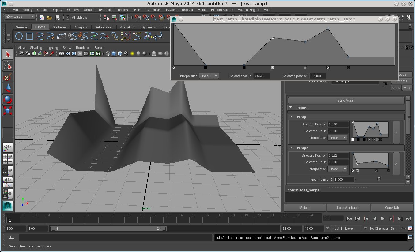

I finally added support for ramp parameters! Both float and color ramps are now supported. It should be available in today's build (14.0.378).

Initial testing seems a little buggy. I see the ramps, which is great, but the keys from my otl aren't set up by default in maya, and any keys I add or change seem to only be appending to whatever is already in my otl, as opposed to adding new ones, or just generally not affecting it correctly. It almost feels like the range is wrong too. It's hard to tell. Any thoughts?
Hm, that's strange. The default ramp values seem to work for me. Which Maya version are you using? Could you try the attached assets and see if the default values are loaded correctly? Are there any errors being printed out?

We're on maya 2015. The attached hda's have the same issue as my own otls. The screenshot shows it as it is initially loaded.
There are no errors, and the ramps don't do anything for me, but I should mention that there are 3 keys, but all set to black and at 0 position.
Haven't been able to try it in 2016 yet.
