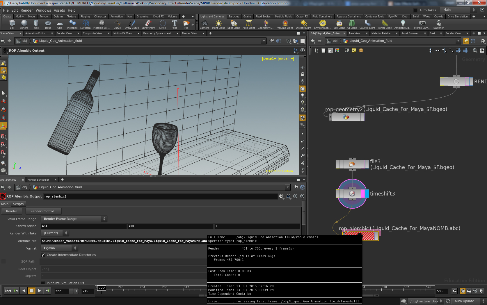

I am trying to export my meshed particles from houdini to maya 2015.
When I export my alembic, it gives me: Error, couldn't save the first frame.
It is important to me that I export this with the V attribute for rendering a velocity pass in maya.
Any suggestions.

Try in Indie or a full commercial version of Houdini.

also does your network evaluate without errors for the frame range set in alembic?
it's difficult to see that as you are on frame 222 and alembic exports from 451

try rename ur path as this liquid_cache_for_mayanomb.$F.abc. u need $F in ur path if wanna save a sequence. also not sure education can export abc or not.
