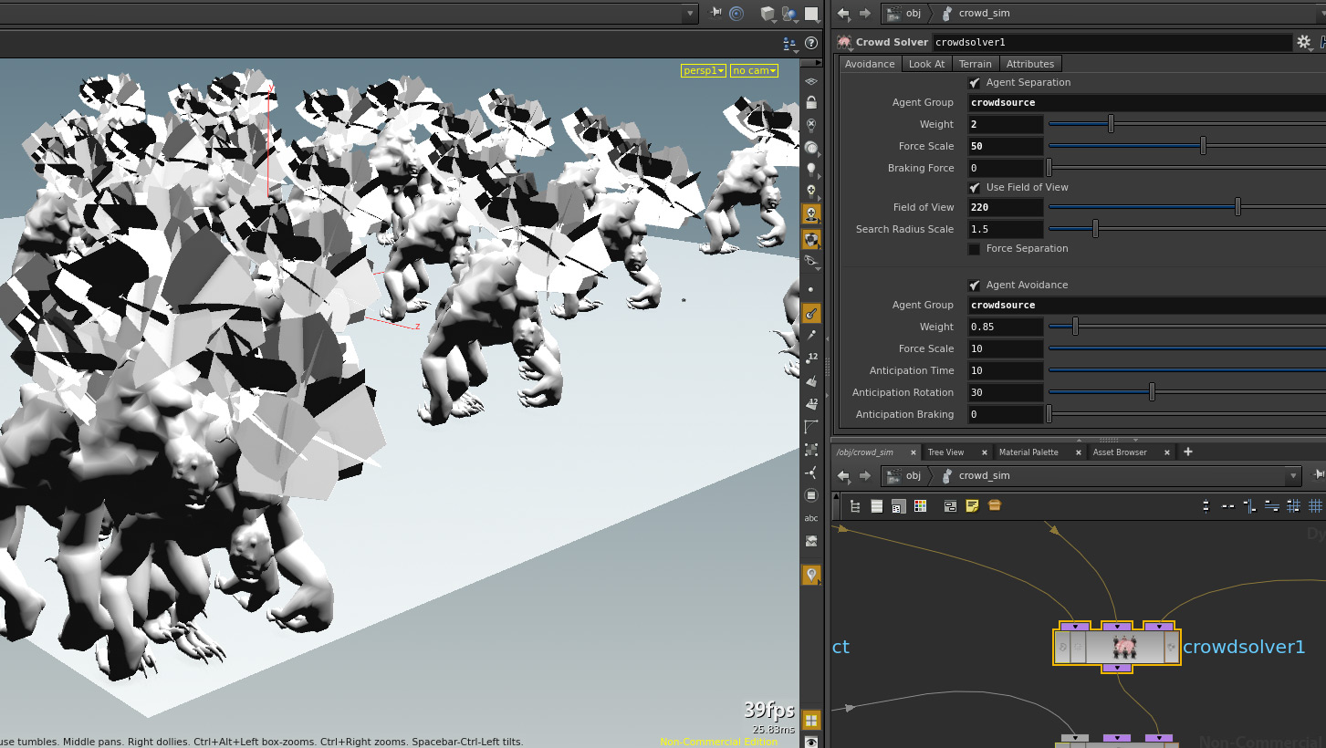

I am still working on my first crowd simulation and I ran into another issue using the system. My agents do not avoid each other. I did not notice this when my agent count was low (7) but when I increased the count (36) I notice that they simply walk right through each other.
The avoidance checkboxes in the Crowd Solver node are enabled. Is there something else I have to turn on to make my agents walk around each other?
I have tried populating the Agent Group with some of the various groups in the provided drop down list but none of them seem to have any effect.

I think I figured it out. It was related to agent scale. My agents are FBX files that were exported from Blender. Blender units seem to be 10x larger than Houdini units.
I went back and re-exported all my FBX files lowering the scale from 1.0 to 0.1 in the Blender exporter and now the agents behave a lot better overall. With this new size, they immediately started avoiding each other and moved at a better pace with the default values from the Crowd Simulate shelf tool.
