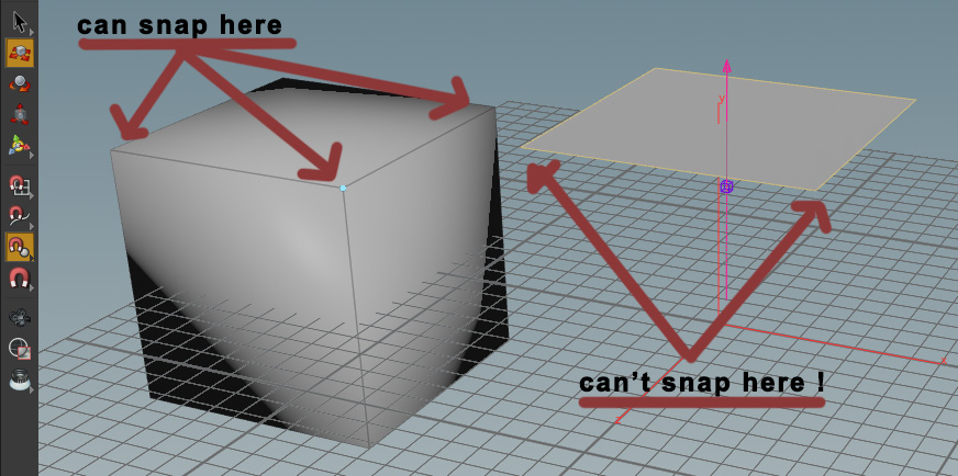

Hello,
I have a grid and I want to snap the pivot's transform tool to one of its points, but I can only snap it on points of others objects (cf. screenshot).
Is there normal ? Is there a workaround ?
Thanks.
snap_01.hiplc (64.1 KB)

282 posts
Joined: Oct. 2015
Finally I understand how to reproduce this bug.
It happens after a move with a middle click increment
step by step :
- select one object (here the plane)
- move it with a middle click increment
- and now, move handle detachment (same thing with pivot) with a point snap and you can see it can only snap to the other object but not on itself.
Can you confirm this ?
Thanks.

282 posts
Joined: Oct. 2015
Same thing with the last 15.0.279 version.
It's really just after a translation with the middle clic increment.
If, just after my middle clic translation, I move manually my object, this problem disappear, and handle detachment can be snapped correcly on itself.
I will submit a bug.
Thanks for your time.
