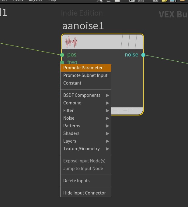

As of Houdini 17 the gear is to the right of each parameter.
From Deborah Fowler's Houdini Interface Tips [www.deborahrfowler.com], I also found out you can MMB on a VOP node to promote a parameter.
Promote Parameter.jpg (91.0 KB)
Promote Parameter MMB.jpg (41.3 KB)
