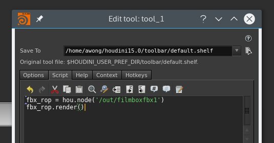

3. Create a new shelf tool, and set the script to:
fbx_rop = hou.node('/out/filmboxfbx1')
fbx_rop.render()
Make sure the ROP path matches with what's in your scene.

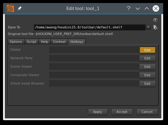

4. In the “Hotkeys” tab, map the hotkey to F12
5. Accept the Hotkey Manager and the Edit tool dialogs
You should now be able to press F12 and save out the FBX file!
