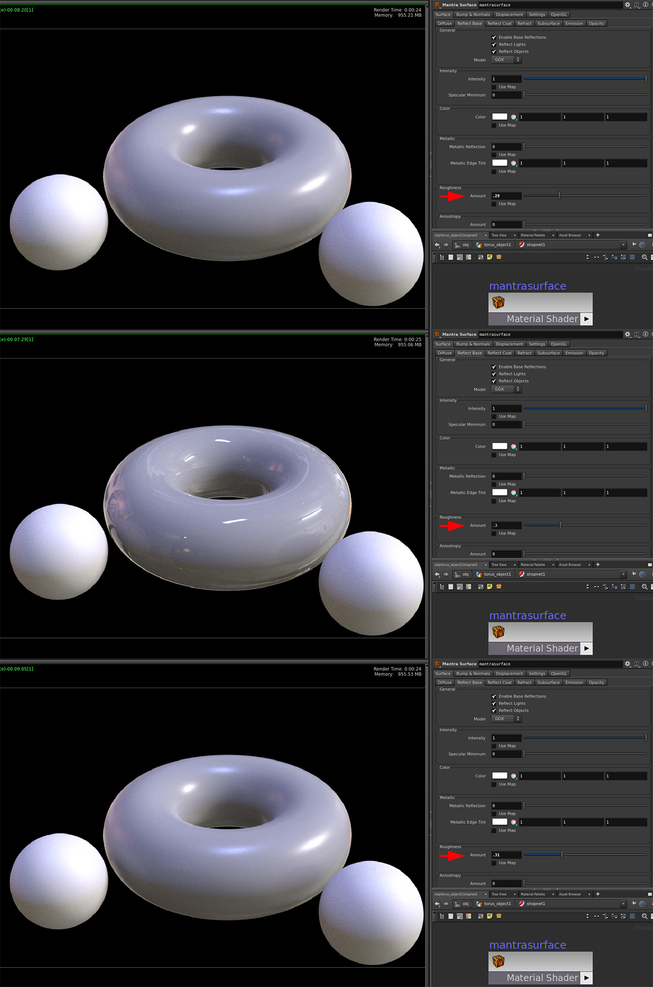

Mossi, your screenshots show that it doesn't render ok. Look how sharp are the reflections on both of your images. That's the same problem that I have. Try decreasing roughness to 0.29, render and then tweak it up to 0.31. You'll notice that in both cases the surface will get much rougher than when it was at 0.3.
Like on the images I'm attaching (with HDR envmap, to make it more visible).
Thanks for testing! This must be a bug.

I didn't noticed that
Yes you are right, the 0.3 is exactly the 0 roughness. so this is probably a bug. let me dive inside to check why.
