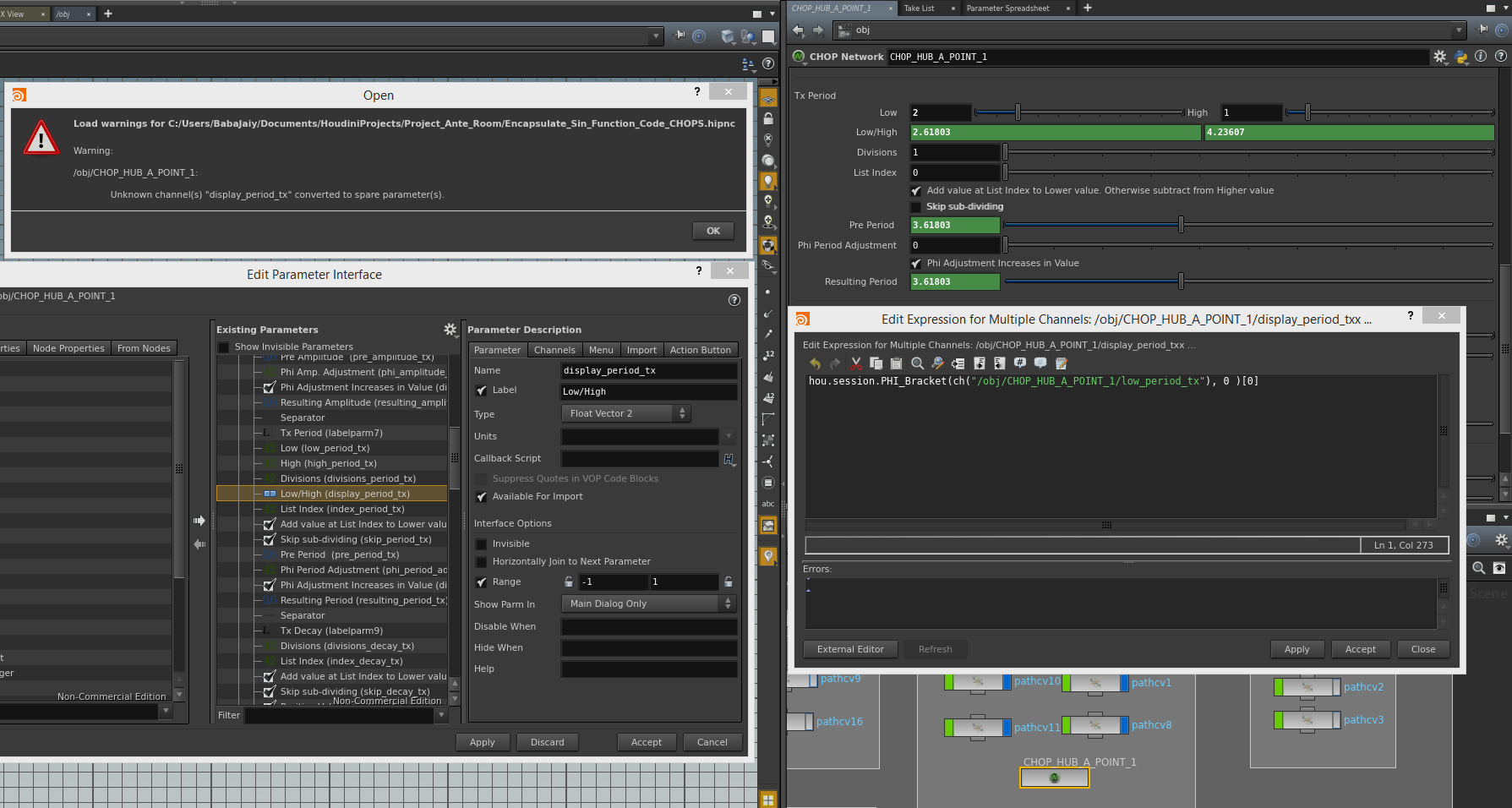

Hello,
I was hoping someone might help me eliminate a lingering warning message.
I can't remember at what point this message got created but I did some copy and pasting of paramters that included some typo mistakes I made for the new parameters. On top of that I had copied the whole CHOP network to be used for other objects but forgot to temporarily delete the export nodes references - so this also created a conflict in the copy process.
All in all I sorted all those mistakes out and the code works just fine as intended. But everytime I open the file this warning message pops up and also a very similar warning ( referencing the same parameter ) comes up everytime I do a copy of my template CHOP.
Like I said my code works fine but this warning message is annoying and I am concerned at some point it might bite me in the butt if I don't take care of it now. As I am going to make many copies of this CHOP network I don't want to be in a situation where I have to go through the code and make many correcrtions.

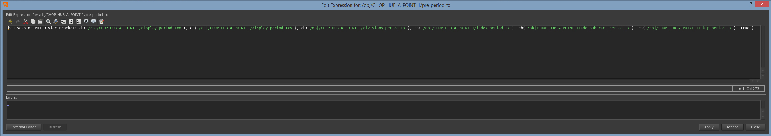

I've included 3 screenshots because I wanted to show all the places that the parameter being stated in the warning message is being used and the editor for expression can only show one parameter at a time.
Any help is appreciated.
